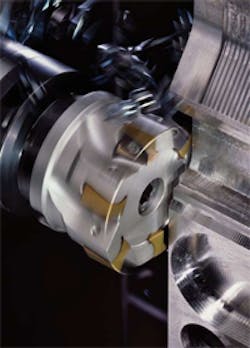

Another shoulder and face milling tool — the CoroMill 490 endmill — has been introduced by Sandvik Coromant (www.coromant.sandvik.com). “The new CoroMill 490 dramatically reduces the cost of operation for face and square shoulder milling,” Hans Lindberg, product specialist for milling tools at Sandvik Coromant, said.
The mill meets the trend toward smaller spindles in machines, small and medium production batches and component requirements in which a reduced depth of cut is needed, Lindberg added.
The maximum depth of cut for the milling tool is 5.5 mm (0.216 in.) and the diameter range is from 20 mm to 125 mm (0.787 in. to 4.92 in.). The company said the CoroMill 490 is equipped with unique insert geometries to produce face milling with an excellent surface finish and shoulders without steps. The tool also can be used for boring applications. The cutters are designed with through-coolant and are available in a
