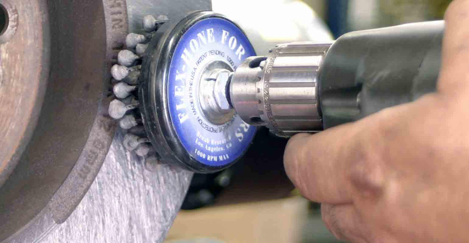

For years the flexible, ball-style hone has been machinists’ first choice for applications that require honing of cylindrical metal surfaces, such as engine piston bores and drilled through-holes. Now, the tool is being recognized for its effectiveness on two-dimensional or planar, surfaces — in a slightly different configuration but with the same filaments and abrasive globules.
This change is creating possibilities for applications in which hardened metals interact or mate in surface-to-surface friction with other metals or materials. Examples include sliding guideways, flywheels, brake rotors, and others.

An alternative approach using cubic boron nitride (CBN) milling tools along with a secondary planar honing operation was proposed in the design experiment. CBN is one of the hardest known materials for machining of steels and cast iron. Unfortunately, the milling process does not create a consistent surface finish. For that, planar honing would be used within the same machining center.
According to the study, the BRM Flex-Hone for Rotors was selected as the tool for the research. The planar honing tool provides a low-temperature abrading process that exposes the undisturbed base metal. In contrast to a “bottlebrush” design used to hone cylinders, the planar honing tool uses the same type of filaments with abrasive globules mounted to a disc. The tool can be held in a collet, chuck, or similar holding device. To achieve an optimal finish, a 400- and 600-grit silicon carbide Flex-Hone for Rotors was selected after it was determined that a fine grain size was all that was required to flatten and create the plateau peaks on the cast iron sliding guideways.
The Flex-Hone tool, along with factors such as pressure, spindle speed, feed rate and number of strokes, was expected to produce a surface finish in the range of 0.3–0.6 lm and 0.2–0.3 lm Ra.
The study concluded, “analysis showed that the ideal plateau finish desired on the hardened cast iron was supported by both measured real parameters and the Abbott–Firestone curve.” Sliding guideways offer only one example of the type of surfaces that could be improved with planar honing. “Other applications that have already benefitted from this type of hone include automotive and motorcycle disc brake rotors, fly wheels, and clutch plates,” Borden said.
