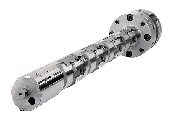

In collaboration with an automotive OEM’s engine block operations, Kennametal engineers advanced the range of boring options (Option 3.0) with “asymmetric line boring.” This is a geometric leap forward that accentuates the advantages of reaming and line boring while virtually eliminating the disadvantages of both.
As with most advanced solutions, the principle at the foundation is quite basic. Normal guide diameters are of full material or built of three or more guide pads, providing no degree of freedom from the bore wall while feeding in and out.
The Kennametal approach supports one guide pad in a setup similar to a typical guide pad reamer, but the guide pad, normally located 180 degrees to the cutting edge, was rotated so the resulting design provides freedom to enter and exit the guide part even passing through the raw bores. This geometry allows feeding the bar through raw bores on an eccentric path. The process looks like this:
— A pilot reamer is fed in and finishes journal 5
— The component (or machine table) gets rotated 180 degrees
— The asymmetric boring bar is fed in off-center using the machining center’s X-Y axis
— The tool is moved to the center and finishes journals 1 through 4 simultaneously
— The tool is retracted off-center with fast feed out.
Kennametal’s bar geometry allows feeding the bar through raw bores on an eccentric path.
Such asymmetric line boring retains all the advantages of established line boring techniques — high-quality precision bores, support on both ends of the tool — while no expensive lift functions, obstructive counter bearings, or critical mechanisms inside the tool are needed. It also adds the fact that complete feed-in and feed-out moves can be done at increased feed rates on conventional machining centers, adding efficiency to the process.
In addition, indexable inserts offered with this eccentric boring bar solution are advanced, too. High-precision RI8 inserts have eight cutting edges with pre-defined back taper, which allows high feed rates. Diameter can be adjusted to the precision of 1 micron. The high clamping force provided by the conical clamp screw avoids any settling effects.
Both inserts and the asymmetric boring bar are designed so the inserts clamp directly into the boring bar body. This eliminates the need for cartridges and the additional tolerances and space they require.
In short, asymmetric line-boring increases machining robustness, process speeds, and reduces tool maintenance and handling, all while being compatible with CNC machining centers.
