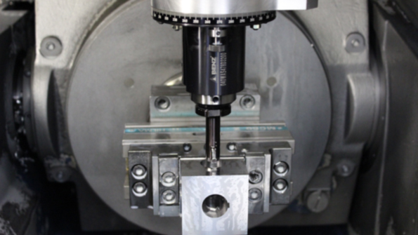

A new and noteworthy development is the introduction of Solidfix, a versatile, modular quick-change collet system that helps machine operators to perform setups and changeovers in 15 seconds or less.
Daystar installed the Solidfix system recently on two new lathes, live tooling Y-axis machines. “We have quick-change adapters on all the live tooling for those lathes,” Lytle said. “We can set the adapters out on the work bench and get everything ready for a setup. Then we are in and out of the machine very quickly.”
The adapters Lytle described are a central advantage of the Solidfix quick-change system. Adapters are attached to individual tools and are inserted quickly and easily into a head via a bayonet-type mount that is then secured simply by turning a single nut using an Allen wrench. Various popular soft tools, such as live turrets, angle heads and static tools, can be interchanged with different size adapters. The system will fit older machining equipment as well as newer models.

In the development of its new modular system, Benz took the original quick-change technology and simplified it. Instead of requiring operators to spin on and tighten tooling in the holder using a wrench, the new system requires only a simple turn of an Allen wrench.
Also, in a traditional quick-change system the operator has to remove the tool and install a new tool. Then, he or she must touch-off their tool to ensure the offset is correct. With the Solidfix, the operator can preset tools on a granite surface plate. When the tool starts wearing or another type is required, he or she simply inserts and secures the new tool.
“Essentially, they’re putting the whole tool aggregate back in, and the repeatability is so accurate that they can program-in what they just measured off their height gauge so they don’t have to go through that scenario of touching-off the tool, and then programming the offset,” according to Mike Starnes, Benz sales application engineer. “So, Solidfix is really a plug-and-play system. Operators just switch out the soft tooling, and they’re all set.”
