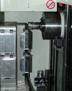

The Ingersoll Aluminator cutter delivers a 4 RMS finish on the gasket channel of a sensing device at Excel Machine and Fabrication, in Baltimore. Retooling with the new cutter eliminated a quality-control problem associated with meeting an 8 RMS spec; halved machining cycle time for the channel; cut indexing time; and eliminated an inspection step.

Excel had to find a better milling process to meet delivery schedules, and to comply with a finish standard that specifically forbade hand finishing. “We had no choice but to impart the required finish as part of the milling,” recalled milling foreman Jeff Grueninger.
The workpiece in question is a 6061 aluminum housing for airborne anthrax detectors, which measure about the size of a paperback book.
Unlike most competitors, R&R Racing custom machines aluminum connecting rods from billets of a proprietary aluminum grade that is 25% stronger than standard grades. Retooling the process with Ingersoll tools cut the cycle for a pair of rods from 55 to 28 minutes — and improved the finish, too.
Grueninger’s principal machining problem was to achieve an 8 RMS finish and a 0.0005-in. flatness in a very difficult gasket channel — as-machined, without taking all day. The customer needed 125 complete housings each week, leaving no time for hand-work even if the specs had allowed it.
First, Excel tried a two-inch wiper-type facemill with four inserts of three different styles, but even at 42 IPM feed or less, surface-finish ranged from 7 to 35 RMS. So, every piece needed a Profilometer check, too often followed by reworking. Moreover, insert edges lasted less than 100 pieces, with indexing taking more than half an hour each time.
“With three different inserts to juggle, it took a rocket scientist to index the thing,” said Grueninger. “It was a real bottleneck.”
He also tried another cutter with triangular inserts, but without any improvement. In fact, cutting loads ran up to 120 percent of spindle capacity.
Trying something new
Ingersoll field engineer Randy Bohn suggested a new facemill for aluminum called the Aluminator, and set up a test on Excel’s Kitamura CNC machine, following modern high-feed milling practices. The new cutter consistently delivered surface finishes in the range of RMS 4, and at much higher cutting rates. The following table summarizes the results, before and after Excel Machining and Fabrication adopted the Aluminator cutters:
Tests vs. the real world
To test the new cutter’s limits, Randy Bohn ran some test parts at 265 IPM. Even under those conditions, surface-finish still remained well within spec, spindle load remained within limits, and the insert edges stood up just fine.
Nevertheless Jeff Grueninger started at the more conservative rate shown in the table above. Even so, he was more than doubling throughput. “We can take risks in a one-time test that we can’t in day-to-day shop practice.” says Grueninger. “We’ll ramp up the machining rate, but gradually.”
Milling the front side is the second step, marking R&R Racing’s first foray into high-speed machining. The Ingersoll Hi Pos+ cutter completes machining time for aluminum con rods in half, and the new settings are 160 IPM/8,000 RPM, up from 20 IPM/1,500 RPM.
After several months, surface-finish has remained so consistently within limits that Excel dispensed with 100% inspection, saving a few additional dollars in its total costs of production.
