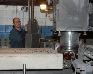

Tangential milling at Atlas Metal Conversion makes quick work of big titanium CP 2 slab. In a single pass, the Ingersoll S-Max mill removes 0.25 in. from all six sides, creating a more uniform feedstock for secondary rolling. A job that used to take 2.5 shifts is now finished in one shift. Inserts lie flat in the cutter, presenting their strongest side to the main cutting force. This makes it possible to achieve feed rates that would wreck a conventional cutter in the high-strength metal. Parameters with the 12-in. cutter are 102 RPM, 16 IPM, 0.300 in. depth of cut. Previously the standard for the same size cutter was 102 RPM , 10 to 12 IPM, and 0.100 in. depth of cut.
Atlas Metal Conversion operators have to index their inserts much less frequently since switching to positive-rake, Ingersoll button cutters with round inserts. The same basic tool mills alloy steels, tool steels, and stainless steels at triple the previous rate, yet inserts last at least twice as long.
Indexing with a tangential S-Max facemill. Note the inserts’ tangential orientation in an Ingersoll S-Max milling cutter as the Atlas Metal Conversion operator indexes the edges. A fundamentally stronger design allows faster cutting without risk of tool failure.
