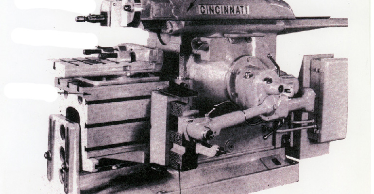

The Shaper
The shaper is a relatively simple machine. It is used fairly often in the toolroom or for machining one or two pieces for prototype work. Tooling is simple, and shapers do not always require operator attention while cutting. The horizontal shaper is the most common type, and its principal components are shown below, and described as follows:
Ram: The ram slides back and forth in dovetail or square ways to transmit power to the cutter. The starting point and the length of the stroke can be adjusted.
Toolhead: The toolhead is fastened to the ram on a circular plate so that it can be rotated for making angular cuts. The toolhead can also be moved up or down by its hand crank for precise depth adjustments. Attached to the toolhead is the toolholding section. This has a tool post very similar to that used on the engine lathe. The block holding the tool post can be rotated a few degrees so that the cutter may be properly positioned in the cut.
Clapper Box: The clapper box is needed because the cutter drags over the work on the return stroke. The clapper box is hinged so that the cutting too] will not dig in. Often this clapper box is automatically raised by mechanical, air, or hydraulic action.
Table: The table is moved left and right, usually by hand, to position the work under the cutter when setting up. Then, either by hand or more often automatically, the table is moved sideways to feed the work under the cutter at the end or beginning of each stroke.
Saddle: The saddle moves up and down (Y axis), usually manually, to set the rough position of the depth of cut. Final depth can be set by the hand crank on the tool head.
Column: The column supports the ram and the rails for the saddle. The mechanism for moving the ram and table is housed inside the column.
Toolholders: Toolholders are the same as the ones used on at engine lathe, though often larger in size. The cutter is sharpened with rake and clearance angles similar to lathe tools though the angles are smaller because the work surface is usually flat. These cutters are fastened into the toolholder. just as in the lathe, but in a vertical plane.
Workholding: Workholding is frequently done in a vise. The vise is specially designed for use in shapers and has long ways which allow the jaws to open up to 14" or more, therefore quite large workpieces can be held. The vise may also have a swivel base so that cuts may be made at an angle. Work that cannot be held in the vise (due to size or shape) is clamped directly to the shaper table in much the same way as parts are secured on milling machine tables.
Shaper Size: The size of a shaper is the maximum length of stroke which it can take. Horizontal shapers are most often made with strokes from 16- to 24" long, though some smaller and larger sizes are available. These shapers use from 2- to 5-hp motors to drive the head and the automatic feed.
Shaper Width: The maximum width which can be cut depends on the available movement of the table. Most shapers have a width capacity equal to or greater than the length of the stroke. The maximum vertical height available is about 12" to 15".
