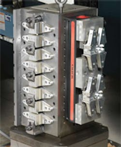

The crossbow job prompted the Scandlons to purchase an a51 horizontal machining center from Makino. The machine accurately machines to the top of its Y axis, and its cone-pallet holding system allows for full Z-axis thrust at the top of the Y axis. The machine’s design let Parkn Manufacturing use the entire workzone fully and to optimize the number of parts that could be loaded onto each side of the fixture.

In the first setup, two sides of the part – the flat back and the inside – are cut. In the second setup, the bottom of the piece is done. The job’s fixture holds eight parts per setup per side.

Parkn Manufacturing runs the part in three total operations, and setups are timed so that the machine is always cutting. At the end of the three setups, the shop has eight finished parts.

Being able to machine accurately high in the Y axis becomes especially important on these parts because 32 of them are fixtured and several of the parts are positioned far above the centerline of the workzone. That position typically is the point at which many horizontal machine tools begin to lose accuracy.
“We needed to count on the fact that the parts on the top of the fixture would turn out exactly as the parts closest to the pallet, a position where most machines are capable of keeping good accuracy. All the parts have to be identical, even if they’re on the very top of the fixture and we’re cutting the most critical features,” Bill said.
Because at least one of each setup is on each side of the four-sided fixture, a batch of parts comes out finished each time the pallet cycles out.
“The key to this part is quantity without sacrificing quality. We have to be able to take finished parts off every time the pallet comes out of the machine to keep production flowing, but we can’t spend a great deal of time tweaking to make sure the parts are perfect,” Bob said.
“The machine has to do that for us, while running very quickly. Our fixture, combined with the accuracy and speed of the machine, allows us to do that. In fact, the machines are so fast, our guys barely have time to load up a new pallet before the one being machined finishes,” he added.
Previously, the crossbow manufacturer used four shops to produce the riser, but there were problems with consistency and on-time delivery. The combination of the Makino a51 and Parkn Manufacturing’s ability to creatively fixture 24 parts in one batch allows it to quickly crank out parts to meet demands.
