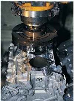

Polycrystalline diamond tooling in a bimetal application for the automotive industry. The milling operation involves an aluminum engine block with cast iron liners.

Because of a chemical interaction between diamond and iron, PCD is not typically used to cut ferrous materials. However, it can tackle bimetal applications involving aluminum and cast iron. For example, an automotive supplier face milled an aluminum/cast iron engine block with PCD tooling, a 12-in. cartridge-style cutter with a 0.093-in. corner radius and wiper. The parts were machined at a 1,000-ft/min speed, 0.004-in. feed, and a 0.20-in. depth-of-cut. With the PCD tooling, the supplier made 5,000 engine blocks before it had to index an insert.
