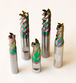

End mills coated with ta-C.

Another example of technology transferred from one market to another is hydrogen-free DLC (ta-C). During the Nanocoat project, a European research program, to develop nanostructured coatings that use environmentally friendly deposition techniques, test were done with several different DLC coatings on automotive engine components (tappets). The tests, which were conducted at the FIAT Research Centre (CRF) in Turin, concluded that ta-C coatings were characterized by the highest hardness and showed the lowest friction coefficient. With the knowledge gained from the Nanocoat project, Hauzer (a research partner) has been able to solve the adhesion issues for ta-C. The result is a range of ta-C coatings with good adhesion and hardness values (40-70 Gpa with DB 1-2) that can be applied industrially.
During impact measurements by a large U.S. engine manufacturer, it turned out that the ta-C coating was still intact with an impact load of 2 kN, just some small cracks were visible. A benchmark coating had already been removed with this impact load. The photo shown here of the Rockwell indent reveals the good adhesion of the ta-C coating. The hydrogen-free ta-C coatings are produced by using arc technology, circular arc or laser arc, and have a diamond-like structure (mainly SP3). A typical hardness of 3,000-7,000 HV can be achieved with ta-C coatings. The typical friction coefficient is between 0.02 and 0.1.
The advantageous features of ta-C together with the solution for the adhesion issues make this a promising coating for precision tooling, according to Hauzer.
