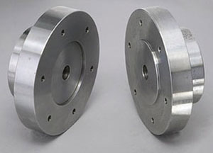

Leyden Transmissions’ coupling components vary widely in size, bearing configuration, and insert designs.
Kurt’s Leader Chuck workholding system is sufficiently flexible to handle a wide variation in component size in high-volume operations, because it achieves quick set-ups from part to part.
