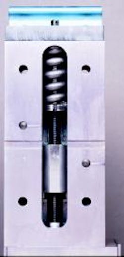

Electricity heats the T-Vise's polymer-filled actuater, which, in turn, operates a piston and die spring to clamp parts.

A die spring in the T-Vise transfers polymer pressure to the jaws. The vise produces 2,900 lb of clamping force and holds a set clamping force to within 50 lb of pressure every time.
