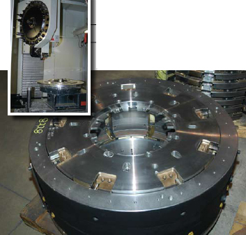

Because of the various pieces involved with a directmachined segmented mold, they have to be assembled within a special container that fits within the press and holds all the pieces together for the curing process.
Northeast Tire Mold invested in a 5-axis Alzmetall for the machining of the tread and a 4-axis Alzmetall for the machining of the containers.

The container material arrives on Northeast Tire Mold’s shop as a flamecut sheet of 1020 steel resembling a giant flat donut or washer that can have an outside diameter of 60 in.
These giant washers are run first on a Defum 3-axis turning center where they get rough machined with a Seco indexable turning carbide DNMG 432 TP200.
“The flame-cut area is tough and leaves a jagged edge, so we have to turn the O.D. to a specific diameter. It’s really tough on the tool, but we machine within 0.001 in. of finish dimensions,” Christie said.
Next, it goes to the Alzmetall 4-axis for the holes.
“The top of the container looks like a piece of Swiss cheese. There are so many different holes and notches in it.”
The most time-consuming part of the container machining process had been the creation around the diameter of the piece of nine 2-in.-deep pockets that are 3-in. wide.
On the previous machine, this was a six-hour operation. With a switch to the new machine that could handle the Seco R217.20 high feed milling cutter used in a plunging operation, this time was cut to a mere 34 minutes.
“We were doing it the same way on the old machine with a 2-in. plunge mill, but we didn’t have near the horsepower on that machine. With the new equipment, we took the tool to its maximum capability within an hour, running at 42 hp and 7,200 rpm,” Ivory said.
