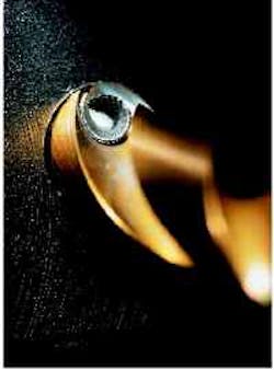

KSEM drills from Kennametal feature a modular insert blade design that permits choice of insert grade. An insert-locking mechanism contained in the drill body prevents chip obstruction. Chips form on the carbide blade, not on the tool’s steel body, extending its life. This design is stable and accurate, even at high feedrates.
TwinGrade GC1030 from Sandvik is a PVD-coated compound grade drill that can double feedrates when drilling stainless steel on machine tools lacking the rigidity for high speed.
Solid carbide drills from Carboloy are self-centering and TiN coated by the PVD (physical vapor deposition) process for high performance and long tool life. Their edge design enhances chip control and evacuation in most workpiece materials including mild and alloy steels, stainless steels, cast iron, and nonferrous materials.
Guhring's Gurojet minimum lubrication system precisely delivers a fine air-coolant mist directly to the drill's cutting edge. The coolant mist travels externally or through internal coolant ducts in the drill.
A Guhring solid, ultra-fine carbide RT 100 high-penetration drill near-dry machines this cast iron part usingthe company's Gurojet system.
