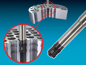

Machining tube sheet grooves can be a long-reach, tight-quarters job. With the Ingersoll double grooving tool, tube sheet holes are created to ASME specs in a single step, and more than twice as fast. In two-inch thick carbon steel tube sheets, users report three-to-one reductions in cycle time versus single groovers, 30% longer tool life, complete elimination of burrs, and much lower tooling costs.
A double-grooving form tool creates ASME-compliant heat-exchanger tube sheet grooves in less than half the time.

A critical aspect to Ingersoll’s tube-sheet grooving tool is that it machines both grooves in one step; the previous best practice was to mill the grooves one at a time.
One early user reported reducing cycle time from 18 seconds to 5 seconds per hole, while eliminating all post-deburring. These times describe an effort at grooving a two-inch thick carbon steel tube sheet with 3/4-inch holes. The user also reported that previously, burrs became a problem as soon as the single tool began to wear even the slightest.

In essence, the new grooving tool is a very sophisticated Ingersoll ChipSurfer double form-slotting mill. With basically one orbiting radial plunge action, the cutter simultaneously produces two identical code-compliant grooves. For a 3/4-inch hole, for example, a 5/8-inch milling cutter carves out two 0.125-inch flat-bottomed grooves spaced with a 0.250-inch gap and 0.030-inch maximum depth.
Like other tools in the ChipSurfer family, this cutter is a replaceable solid-carbide tip that screws onto a shank, made of either carbide or alloy steel. The repeatability with tip replacement is 0.0005 in., which eliminates dead cycle time for “touching off” or offsetting after each tip change.
Because of the tight quarters – only 1/8-inch of clearance between a 5/8-inch tool working in a deep 3/4-inch ID hole — “doubling up” wasn’t as simple as it may seem. “It is a long-reach operation in a high-aspect hole, which generates chips twice as fast as a single slotter and can double the lateral forces,” Dieken explained. As a result, he settled on a four-flute design that balances chip evacuation space with chip load per tooth, and a high-positive presentation geometry to minimize cutting forces.
