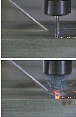

A new PVD coating technology for dry machining protects cutting edges from wear while simultaneously ensuring reliable chip evacuation.
Chips flow through the flute of the Balinit HARDLUBE coated drill as if the drill was lubricated. After drilling the same number of holes, the TiALN coated drill must be replaced.
Surface quality after the same number of drilled holes: TiAlN (left) and Balinit HARDLUBE (right).

To substantiate its effectiveness, a demanding dry drilling test was conducted. Test tools drilled deep blind holes (drill depth being four times drill diameter) in alloy steel to differentiate the performance of the new coating versus uncoated and TiAlN-coated standards. The uncoated drill broke almost immediately after one hole, the TiAlN-coated drill produced 85 holes, and the Balinit HARDLUBE-coated drill delivered 108 holes. With the specially coated tool, tool productivity increased without the need for expensive, environmentally hazardous lubricants.
