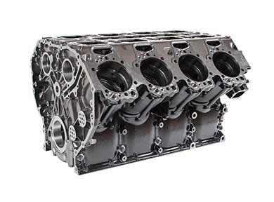

Stockholm-based Scania manufactures trucks and buses for distribution worldwide, and it’s also well-known for the quality and reliability of its diesel engines. The availability of new, lighter grades of cast iron – compacted graphite iron, or CGI – was a breakthrough in engine design, but before adopting it the Swedish manufacturer had to address a critical concern: Would existing machines and tools be able to work on this new material? If not, how would Scania manage their production process?
“The background was this new form of cast iron, which offered many advantages – it is more environmentally friendly and it’s also stronger, which means that they can make the engine walls thinner and lighter,” recalled Seco Tools’ Stefan Frejd, R&D Specialist, Drilling. “The problem that Scania wanted to explore was the fact that this material increased the wear on the production tools, which of course shortened the life of the tools.
“The challenge was to find a way of extending the tool life for the milling cutters, drills, and reamers that would be used on this new material.”
A project group was formed – and its work paid off almost immediately. “We got together with Scania’s engineers and discussed some of the problems and the applications they used, and then we came back with some new tools to be tested,” Freid explained. “The first drilling tool we tested turned out to have a tool life of more than 20 times the existing one, so that was a huge improvement.”
Other test tools managed to outlast their predecessors by a factor of seven, which represented a huge breakthrough for both Scania and Seco.
