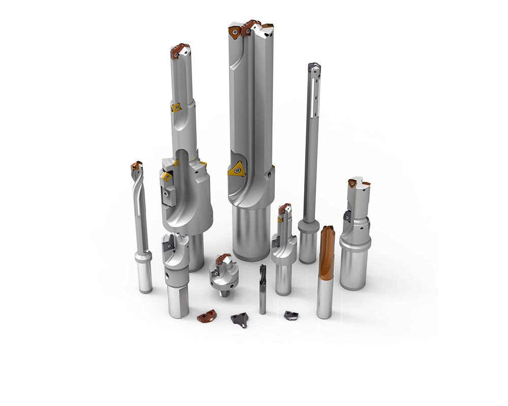

Like the process of assembling a jigsaw puzzle, creating special tooling challenges Allied Machine’s application engineers to determine where the tool will work more efficiently and effectively than standard tooling in specific holemaking and hole finishing operations. Additionally, their online utility, Insta-Quote, allows machine shops to design, quote, and order special tooling more quickly for simpler tooling requests. “Specials” can be an excellent choice in these instances, and provide great return on investment, but understanding a machinist’s needs for the tool is an in-depth process.

One of Allied Machine and Engineering’s standard product lines, AccuPort, is used for this. Three to four operations may be combined into one tool in instances where spot faces are smaller than the standard, or the minimum thread length is longer than what the standard tool produces.
The Superion burnishing drill is another Allied Machine product that is often used to combine functions to create custom tooling. The specific geometry of this drill achieves better surface finishes and hole sizes than what a standard high- penetration drill might produce.
Finally, adding a back chamfer and top chamfer to a hole can be done when applying special tooling. Instead of drilling a hole and using different tools for the back and top chamfer, the application engineers can combine that operation into one tool with the T-A back chamfering tool.
