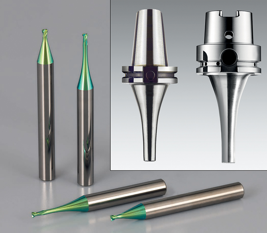

The new end mills feature a patented neck design capable of reaching into deep contours, plus high radial bending strength. The new milling/drilling chucks have a slim design for hard-to-access areas, and high gripping torque and accuracy.
EMUGE CORP. Micro end mills and Micro milling/drilling chucks are suited for a wide range of applications in die and mold, medical, and other types of machining operations. The Micro end mills feature a patented neck design with up to 10x diameter, enabling reach into deep contours. For optimal machining performance, a high radial bending strength withstands alternating stress on the cutting edge and relieved neck. The Emuge end mills offer high-speed cutting and finishing of 2D and 3D contours and are offered in square, ball nose, and torus end types. Featuring a short, stable cutting geometry, the end mills are available in solid carbide and CBN designs.
The solid-carbide Micro end mills are designed for high-precision machining applications up to 55 HRC and can machine small engravings, electrodes, components, and cavities with varying depths. For heat and wear resistance, the end mills have a PVD-applied, thin-film ALCR coating that results in long tool life. Ball-nose and Torus solid-carbide end mills provide high accuracy dimensional tolerances of ±5 µm. The solid carbide end mills are available with neck lengths of 2.2x dia., 5x dia. and 10 dia. and a cutting diameter of 0.2 to 2 mm.
Emuge CBN Micro end mills offer increased tool life for high precision, accurate machining applications up to 66 HRC. The end mills produce highly polished surface finishes without the need for rework. The CBN Micro end mills are available with neck lengths of 1.5x dia., 3x dia. and 4.5x dia. and a range of cutting diameters from 0.3 to 2 mm.
Emuge Micro milling/drilling chucks feature a slim design for hard to access areas, as well as high gripping torque and accuracy. The Micro chucks are part of the high precision/ performance Emuge FPC mill/drill chucks line, providing unprecedented rigidity, vibration dampening, concentricity, machining speed, and tool life versus conventional chuck technologies for milling and drilling applications. Featuring the world's only chuck with a 1:16 worm gear, the Emuge FPC chuck's patented design delivers three tons of traction force. The unique design and body provide 100% holding power for maximum rigidity, and the collet-cone assembly absorbs virtually all vibration for maximum dampening.
Emuge Micro chucks are offered in a range of models in five shank styles (CAT, HSK, SK, BT and PSC) and hold 1 to 6 mm or 1/8 to 1/4-in. shank tools. Specially coated collets provide high strength and lubricity. For ease of use, the chucks can be operated from behind with a supplied hex-key. Learn more at www.emuge.com
