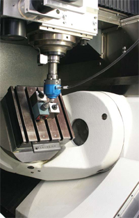

R-test trunnion setup on C-axis machine configuration (above). The master ball is mounted on the table and the probe is mounted in the spindle for measuring alignment and contouring errors in three directions simultaneously in less than 20 seconds.

During the R-test, the measuring head, or MT-Check probe, is fixed to the spindle or non-rotating part of the machine. The spindle location with probe does not rotate during the test.
The probe contains three planar elements that are brought into contact with a 22-mm diameter master ball that is mounted on a rotary table affixed to the machine’s trunnion.
Three accurate measuring systems within the probe monitor the displacements of three corresponding contacting elements during this motion. In this way, the center point coordinates of the ball are determined with sub-micron accuracy in X-, Y- and Z-directions.
The R-test can be performed to determine axis deviations during movement of the rotary table or the trunnion table only, or during the simultaneous movement of both.
As the rotary table and trunnion go through their motions, the probe measures the real position of the master ball centerpoint. Readings from the probe are displayed on a laptop near the machine. With the R-test a full, three-dimensional measurement is performed. With one measurement, that usually takes less than two minutes, the location is determined in two directions as is the parallelism of the rotary axis in two directions.
