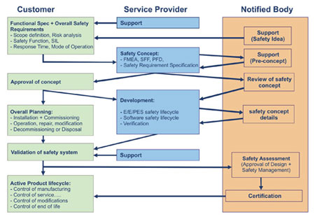

Figure 1. Customer cooperation via MESCO – TUV.
IEC 61508 details the methods and requirements for minimizing the health and environmental risks for facilities and machines. Anyone who participates in the product lifecycle in any way is affected and responsible. Anyone who wants to sell a SIL product for the first time has to develop the product conforming to the Functional Safety standard. Additionally, a Functional Safety Management program must be established and demonstrated in the organization, in order to apply the shifting of the burden of proof in court in case of an accident.

Step 1b — Functional Safety basics seminar (management should be involved) (see Fig. 1)

In a product development phase the first steps are essential: MESCO supports customers beginning with the IEC standard via the safety concept and its implementation to a producible product. MESCO’s “TUV-certified Functional Safety Engineers“ implement clients' ideas into the required hardware and firmware. Because MESCO provides the customers with all project documentation, product maintenance and further development can remain in the manufacturer’s organization. Customers will benefit from our cooperation with TUV (Fig. 1), from shared and aligned processes, and from the SIL certificate for their product.
