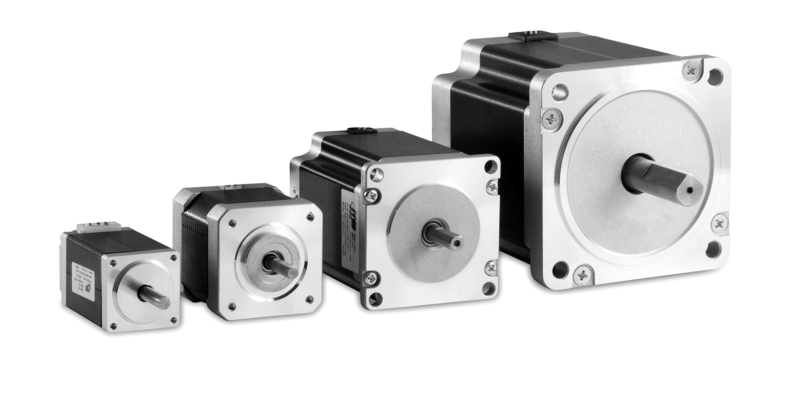

Four Common Frame Sizes for Stepper Motors for Automating Machining Centers
1. NEMA17 (42 mm x 42 mm) are used on the smallest benchtop engraving machines and 3D printers. They have a holding torque range of 0.20 to 0.83 Nm (28 to 120 oz.-in.)
2. NEMA 23 (56 mm x 56 mm) are widely used on small- to medium-sized machining centers and some larger, benchtop systems with moderate load requirements. NEMA 23 motors also serve in laser and plasma cutting systems where the only required force is move the cutting head. Holding torque for these stepper motors is from 0.82 to 3.20 Nm (120 to 450 oz.-in).
3. NEMA 34 (86 mm x 86 mm) are used on medium to large benchtops and free-standing machine centers. They are a good-sized motor for converting all but the largest manual machines to CNC control. Able to produce a good amount of torque over a modest speed range, these motors produce holding torque from 3.70 to 11.90 Nm (520 to 100 oz.-in.)
4. NEMA 42 (110 mm x 110 mm frame) is one of the largest commercially available stepper motors that produce upwards 32 Nm (4532 oz.-in) of holding torque. This motor size is used in industrial machining centers and to convert the largest manual machining centers into high-power automated machines.
