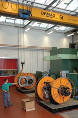

Demag’s crane kits are supplied with all components, including a wire rope hoist, end trucks, bridge panel, festoon system with brackets and push button station.
