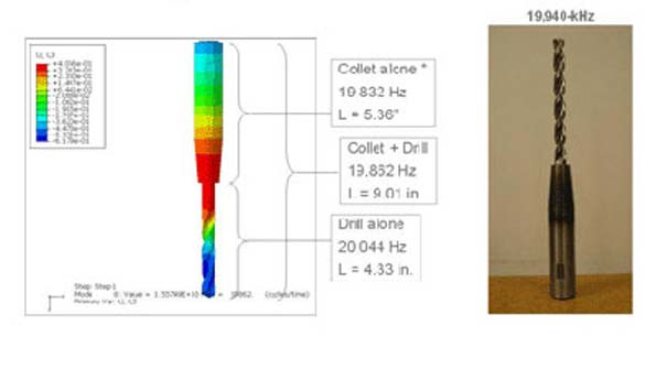

Figure 1. A collet-drill assembly was modeled prior to installation. In actual performance, the frequency of the full wave tool came to within 99.7% of the target frequency.

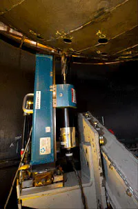

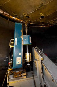

Figure 2. A portable AcousTech Machining system was developed to reduces critical component downtime when machining nuclear pressure vessels.

An important innovation in implementing this technology was to couple cutting tools to an ultrasonic transmission line effectively, while isolating completely the vibrations from sensitive machine tool components. Modeling and simulation were used extensively in the design of the transmission line to achieve the desired vibration frequencies and to direct the energy where it is needed — at the cutting tool. Figure 1 illustrates an example in which ultrasonic machining was modeled in use with a collet drill prior to installation. During the actual production, the frequency of the full wave tool was within 99.7% of the target frequency.
The technology is showing benefit for a range of applications. The process has been demonstrated to increase feed speeds by 2-6X and life of cutting tools by 6-10X, depending on the material being machined. Recently, EWI developed a portable AcousTech Machining system (see Figure 2) for an application involving nuclear pressure vessels, intending to reduce critical component downtime by eliminating process steps, excluding cutting fluids, improving accuracy, and increasing tool life. EWI demonstrated the effectiveness of this technology on a mock-up reactor in which the total cycle time per 43-mm diameter / 60-mm deep drilled hole was reduced by over 90%, while tool life was increased by a factor of 10.
