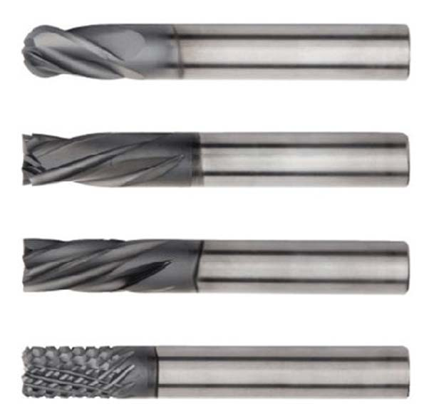

Kennametal reports its new KCN05 Beyond milling cutters, specially developed for milling CFRP, deliver long service lives and achieve high-quality surface finishes, thanks to the combination of a special substrate and a grown diamond layer.

For machining work on pure CFRP, the burr-style router is a universal tool that is being optimized continually. The Kennametal down-cut style router has been specially designed for milling recesses and surfacing work.

Above all, according to Sax, what are known as compression style routers, with their V-shaped geometry, spiraled to the right at the tip and to the left on the shaft, provide the optimal set-up for cutting grooves and trimming work. "The V-shaped inverted spirals press the matrix layers together,” Sax said. “That enables us to execute very fine surfacing work."
The burr-style router
For machining work on pure CFRP, Kennametal offers a universal tool — the burr-style router. It is constantly being optimized through further development, and service lives of 25 m can be achieved currently.
The down-cut style router has been specially designed for milling recesses and for surfacing work. The main advantage of the left-spiraled tool lies in the higher cutting speeds that can be reached. For this tool, the developers have resorted to a substrate with a low cobalt content, to enhance the adhesion of the diamond layer, and therefore to create a very easy-cutting tool.
