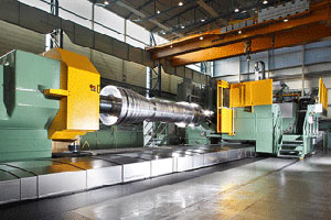

Currently, designers at the Georg machine tools division are completing an upgrade for Siemens manufacturing center in Görlitz, Germany. A turbine rotor lathe first installed in 1963 has been updated, including a new headstock and new machining unit with integrated drilling and milling systems.
The modernization will provide an increase of the machine’s center height by 200 mm. Thus, the maximum turning diameter has been increased to 3,200 mm. Further, the new machining unit makes it possible to conduct complete machining processes on a single machine, e.g., the milling of “fir tree grooves” and application of flange drills. With higher performance and torque the new headstock ensures increased manufacturing capacity and an economically more efficient production process.
