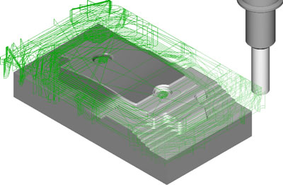

VoluMill Universal generates two- and three-axis toolpaths (shown here) for any geometric configuration, including open shapes and islands, in any format from any CAD/CAM system.
