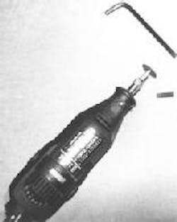

My idea is for easily producing custom, hex-head socket screws. The quick procedure is coldworking, so it generates sockets harder than those produced by EDMing.
The cut off piece of hex key must be square to use as a broach.
Run the hex-key broach into the workpiece to produce a hexsocket pattern.
A finished lefthand 1/4-20 screw with custom head made using the special broach idea.
First, I cut off a 1-in.-long section from the straight end of a hex key, making sure the cut surface is square because the piece needs to work as a broach. Then I mount a drill the size of the hex key's major diameter in a lathe's headstock chuck and clamp a piece of steel (approximately 1/2-in.-thick) in a toolholder secured on the machine's toolpost. By moving the piece of steel into the drill using the lathe carriage, I drill a hole for guiding the broach.
Finally, I load rod stock in the machine chuck and drill — with a bit matching the hex key's flat-to-flat distance — to a depth of 11/2 the drill's diameter. With the short piece of hex key in the guide hole, I hammer it into the workpiece until it reaches the bottom of the hole, thus producing the hex pattern.
The broach is removed with a pair of visegrips and a few light taps. For the finishing touch, I chamfer the hex socket's entrance using a countersinking tool.
