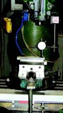

Locating a convenient spot for mounting a magnetic indicator base to a milling machine is often next to impossible. To eliminate this time-consuming task, I use a carbon-steel ring with three small plates attached that fastens to quill housings on Bridgep
Locating a convenient spot for mounting a magnetic indicator base to a milling machine is often next to impossible. To eliminate this time-consuming task, I use a carbon-steel ring with three small plates attached that fastens to quill housings on Bridgeport-type mills. Three setscrews allow for adjustment and hold the setup in place.
Counter-sunk machine screws secure the plates, which provide a flat working surface. The ring front is cut to accommodate machine-quill housings.
I also have a ring for Cincinnati-type mills. The ring is 5 /8-in. thick and 5 /8-in. wide with 1 1 /2-in. flats machined at 120° for a Bridgeport and 90° for a Cincinnati. About 0.005 in. of clearance on the ring's I.D. provides a close fit. I not only use the setup for indicator bases but also for coolant wands.
