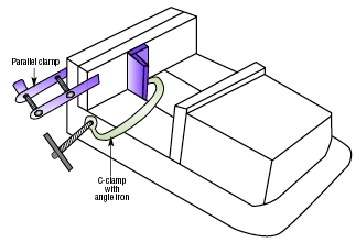

Quick workstop
For a quick workstop when the part and setup allows, I use either a parallel clamp or C-clamp with a short piece of angle iron, if possible. These stops take less than 20 sec to set up and are sturdy enough for those machine operators who are a bit rough
For a quick workstop when the part and setup allows, I use either a parallel clamp or C-clamp with a short piece of angle iron, if possible. These stops take less than 20 sec to set up and are sturdy enough for those machine operators who are a bit rough when loading workpieces. The clamps also seat below the workpiece's surface, thus eliminating interference.
Joseph Snyder
Jackson, N.J.
