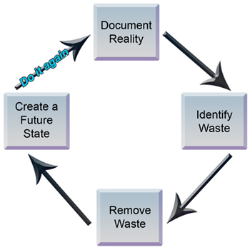

Lean Manufacturing is a very effective method for making improvements within organizations. I first became aware of Lean when I joined Goodrich Corporation as a Manufacturing Engineer 13 years ago. I was trained and certified in Lean, and participated in numerous Lean events in our manufacturing operations. I quickly realized the advantages of Lean though Kaizen events with dedicated team members making improvements. Now, as a Continuous Improvement Specialist, I have learned that there is a simple 4-step approach to applying Lean.

Once the process is completed, plan to do it again. This is why we call it “continuous improvement”: it’s a journey. Remember Lean is not a four letter word, but a four step process. Keep it simple in implementing your Lean initiatives and learn by doing. It is amazing what a team of motivated employees can accomplish together.
