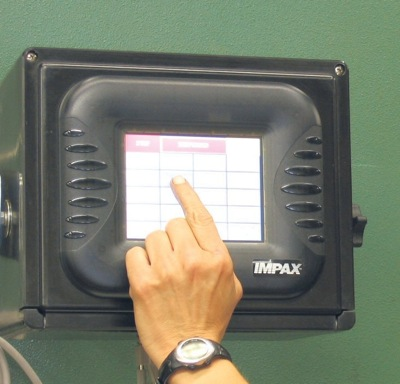

The Impax TSS-6 automatically monitors machines and, when it senses downtime, it asks operators to enter a code related to the reason that the machine is down. Operators can plug in 64 error codes to report to the network database on the downtime.
While most reporting systems use proprietary software, the Impax TSS-6 interface, for pulling up reports and viewing information, uses a MicroSoft Excel program because many press operators and others in manufacturing are familiar with that software. Also for ease of use, Impax TSS-6 system monitors feature touch screens, so operators do not have to use a mouse and keyboard.
