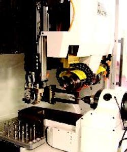

ECO loaders, which come standard on Walter Grinders' Helitronic Power machines, let one Rocket Supply operator run up to four cutting-tool grinders.

Despite its simplicity, the ECO loader handles tools up to 81/4-in. long and 1 in. in diameter. It accommodates different tool types in any order (wheel sets permitting), and for manufacturing, shops can use bushings in pallets for various diameters. Since work head collets are not exchanged, only one shank diameter is possible within a batch.
When regrinding, collets handle different diameters within a batch. Users can also set up a second pallet outside the machine and change out 20 tools in seconds.
Rocket Supply's operators manually loaded parts one-at-a-time. Now, they load the loaders, and grinders run for up to 51/2 hr unmanned, which gives them plenty of time to concentrate on grinding the shop's specialty tools on another grinder.
