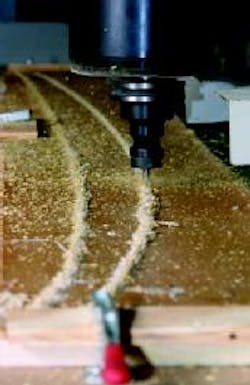

Pacific's GR-510 cuts two stringers from a single board secured with clamps.
Pacific CNC Machining uses a Haas GR-510 gantry router to produce surfboard components.

TO INCREASE PRODUCTION AND quality, while maintaining a one-of-a-kind product, many surfboard companies venture offshore to reap the benefits of inexpensive labor. But for Szabad International of San Marcos, Calif., the solution to producing more surfboards was across the street at Pacific CNC Machining.
Pacific has a Haas GR-510 CNC gantry router with a 40-taper milling head and 53 10-ft table that easily accommodates surfboards. Not only has the machine increased production for Szabad, it has improved the quality and repeatability of the company's surfboard components. "We've taken the product from being a rough, labor-intensive process to an extremely repeatable one," says John McClain, owner of Pacific CNC. "The GR-510 machines every part the same and eliminates seven assembly operations for Szabad." He says Szabad has tripled its production.
Pacific, using the GR-510, makes stringers for Szabad's performance softboards. Unlike traditional surfboards, which have a foam core and a hard outer skin of fiberglass and resin, softboards are soft foam with polyethylene bottoms and rigid stringers running down the center of the board.
These wood stringers form the softboard's backbone. They are wood and create the rocker, or curve, of the board, while providing the stiffness and high performance that surfers desire.
For additional strength, Szabad laminates the stringer wood with fiberglass before delivering them to Pacific for machining. McClain uses a fixture made from particle board to hold the material in place on the GR-510. A vacuum system secures the fixture to the machine's table, and clamps hold the stringer material to the fixture.
McClain cuts the stringers with a 1/4-in. end mill for wood. The 11/2-min cutting cycle generates a lot of sawdust, but a vacuum system mounted next to the end mill clears away most of the loose debris. With cutting speeds up to 833 ipm, it doesn't take long to work through a stack of boards.
"Before we started cutting the stringers, Szabad was making them by hand using templates and a bandsaw," relates McClain. "On a good day, the company produced about 20 boards. By us cutting the parts on the gantry, it now makes up to 100 boards a day without too much trouble."
In addition to cutting the stringers, McClain uses the GR-510 to shape the foam for the softboards. The foam blanks sit on the machine's table and are cut to shape in four operations. Previously, workers at the surfboard company had to cut the foam by hand using routers and templates.
