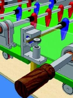

Kevin Bowen used Auto CAD Inventor software to design his electronic foosball table.

DC servo motors power the two-part rods that slide back and forth and rotate. The servo motors connect to gear-and-rack assemblies for back-and-forth motion, while square rods and timing-belt-and-pulley systems provide rotation.

Bowen redrew the table using AutoCAD Inventor software from Autodesk Inc. (www.autodesk.com). This 3D mechanical-design application integrates 2D drawing with 3D modeling to allow engineers such as Bowen to leverage their years of AutoCAD expertise and benefit from 3D modeling and functional-design capabilities. The software includes built-in data-management tools and allows for design-data sharing across engineering workgroups and to users outside design teams.

Bowen is currently in the process of redesigning Foosbot to beef up its structure, and using Inventor lets him check tolerances and make sure there are no interferences in the table's actuation system. He also plans to mount flat-panel displays above the playing field to create a mini jumbotron look.
