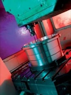

A Renishaw probe checks an aerospace wheel at Dunlop Aerospace. For its done-in-one production strategy, Dunlop Aerospace Braking Systems, a manufacturer of aircraft wheels and brakes, invested more than $3 million for a cell ...
