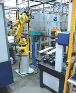

Each 30 ft. by 10 ft. (9.1 m by 3.1 m) work cell consists of two machining areas and one subassembly area. Each machining area has a Mori Seiki vertical machining center, a Fanuc machine-tending robot, a compressed air blowout system, a Mitutoyo CrystaApex C CMM, a deburring wheel and two small conveyor belts that lead to and from the subassembly area. The subassembly area has a bushing press, bushing dispenser, and a visionequipped Fanuc transfer robot.
How it works
An operator loads palettes of castings onto the load table. The machinetending robot takes a casting from the table and loads it into one of eight fixture stations in the machining center. The machining center cuts a hole in the casting. The robot removes the machined casting from the fixture station while jets of compressed air clean the part, and puts it on a conveyor for delivery to the subassembly area. When the machined casting reaches the subassembly area, the transfer robot loads it into the bushing press, gets a split bushing from the bushing dispenser, and puts the bushing on a small rotating table which turns the bushing while the robot scans for the split. The transfer robot then moves the bushing to a press that installs the bushing into the hole on the casting, after which the transfer robot removes the casting with inserted bushing from the press and puts the assembly on the conveyor belt leading back into the machining area.
The machine-tending robot takes the part from the conveyor and puts it back into one of the eight stations in the fixture where it is machined to its final form. The finished part is removed from the fixture, deburred and put into the CMM fixture.
The CMM measures the hole diameter, X-location, Y-location and Zheight of the part. The measurements are recorded in the MeasureLink database and displayed on a screen with color-coding. Part information is color-coded green, yellow or red depending on whether or not the part is within tolerance. Parts that are outside tolerance are moved by the machine-tending robot to a red ink daubing station to flag it as rejected, then the part is placed on the work-completed palette. Good parts also are placed on the work-completed palette.
