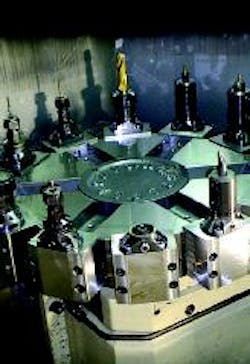

Over the last four years SOR upgraded all of its equipment and reorganized its staff and processes. The new equipment enables them to run 24 hours a day four days a week and they are looking at using material loaders to enable 24/7 operations. When they first tried to run 24 hours a day they ran for more than three hours unattended in the early morning. Because more than 80 percent of what they machine is 316 stainless steel there were some problems with tooling failures, so they adjusted their shift times to provide two hours of unattended running in the early morning and another hour and a half in the afternoon. Their newest work cell uses a 4-axis horizontal machining center serviced by a 36-palette material loader and is capable of running unattended up to 24 hours a day.
