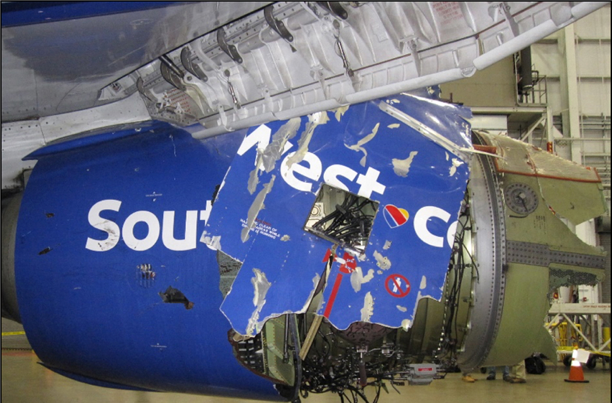

The Boeing Co. agreed to correct a design detail on an undetermined number of CFM International CFM-56 engines installed on 737 Next-Generation aircraft, at the direction of the National Transportation Safety Board. Among the actions the OEM described: supporting the engine manufacturers’ recommendations for fan blade inspections; and introducing inlet and fan cowl design changes “to enhance their ability to withstand an engine fan blade out event, as well as to increase the overall capability of these structures.”
The NTSB recommendations result from an investigation into the April 2018 incident aboard a Southwest Airlines flight, in which a part of a fan blade broke loose and broke a passenger window. The incident caused damage to the aircraft, forced an emergency landing, and led to the death of one passenger and minor injuries to seven others.
