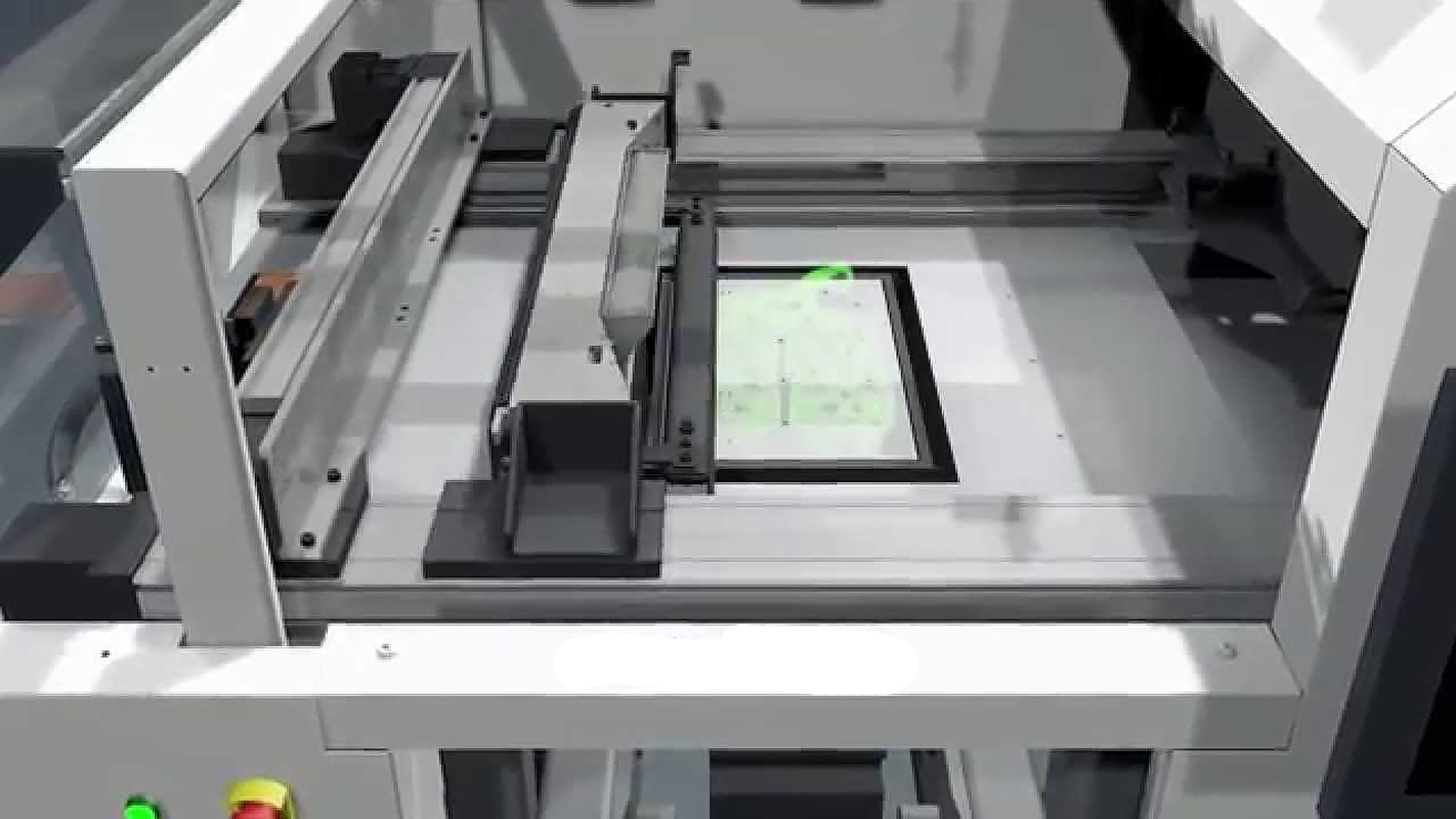

Additive manufacturing technology supplier The ExOne Co. licensed a patent-pending technology for 3D printing aluminum-infiltrated boron carbide (B4C) collimators, and other components used in neutron imaging, from the U.S. Dept. of Energy’s Oak Ridge National Laboratory (ORNL). ORNL researchers used the ExOne M-Flex® binder-jet printing system used to produce 3D objects in metals like stainless steel, bronze, or tungsten, as well as to print objects in sand, ceramics, and composite materials.
