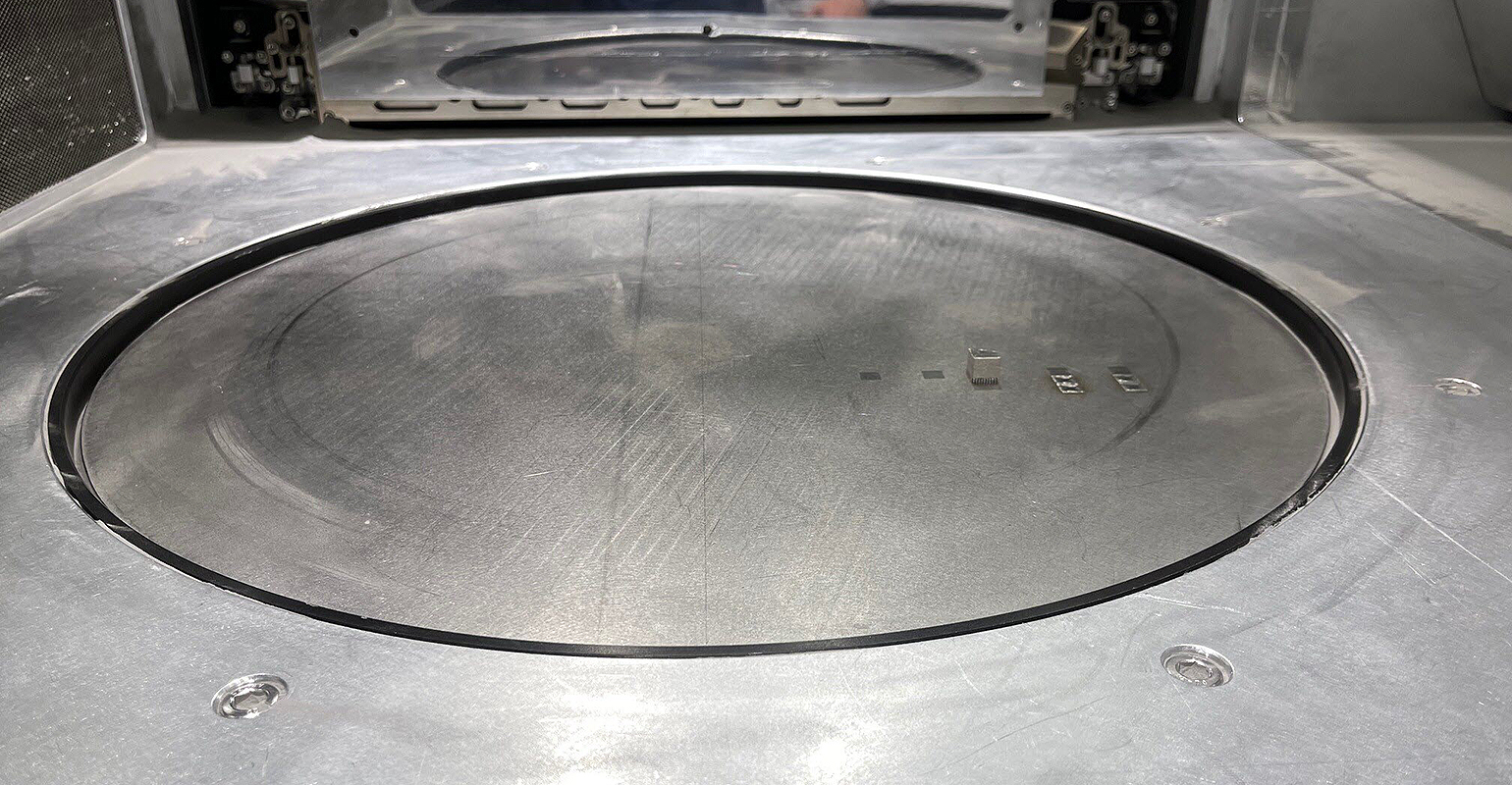

Velo3D Inc. reported it shipped the first scaled-up version of its metal additive-manufacturing system to a producer of critical aerospace parts: The Sapphire® XC (“Extra Capacity”) is its largest metal 3D-printer that uses the same print preparation and quality control softwares, and the same manufacturing process.
The Sapphire printing technology is a laser-based powder-bed fusion process.
The system developer reported it has firm bookings from manufacturers for 17 Sapphire® XC systems, plus 19 more reservations. Velo3D explained the demand is based on the lower production costs for customers who have adopted Sapphire 3D printing technology and its ability to produce much larger parts. The improvements include a larger build volume (600 mm in diameter and 550 mm high, which is 400% larger volume than the original Sapphire® system); eight 1-kW lasers to selectively weld powdered metal layer-by-layer, compared to two 1-kW lasers for the original design); and a faster non-contact recoater, a proprietary Velo3D process that is “protrusion-tolerant” and twice as fast as the original version’s capability.
The new Sapphire® XC is able to print a wide variety of materials often used to produce mission-critical parts for aviation, aerospace, defense, oil-and-gas, and energy sectors. The available metals include Inconel 718 & 625, Hastelloy® X, Hastelloy® C22, aluminum, Scalmalloy©, and titanium Ti-6Al-4V.
