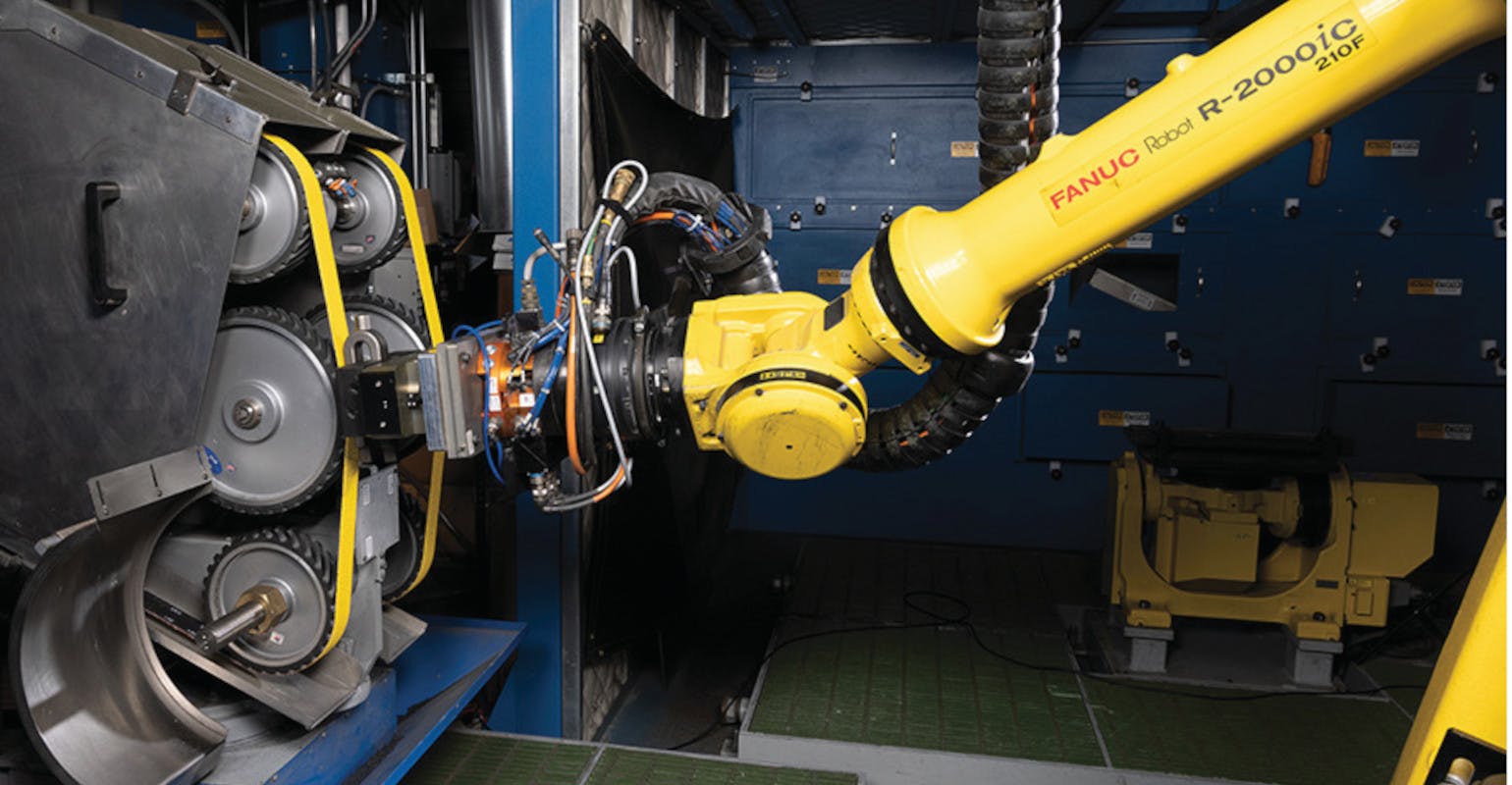

A highlight of the exhibit will be the Norton Abrasive Process Solutions (APS) Program that provides custom grinding expertise by helping customers determine optimal grinding or finishing solutions, from simple to complex, off-hand or automated, and for metal fabrication, production grinding, and virtually any abrasives operation. The APS Program draws on the knowledge of the Norton team along with access to 30 different machines, and a state-of-the-art APS Robotic Automation Cell at the Higgins Grinding Technology Center in Northborough, Mass. The APS team provides abrasive process development, optimization, automation, and in-house testing. APS services encompass the testing and optimization of new abrasives, improving quality and/ or throughput, and exploring entirely new and customized processes.
