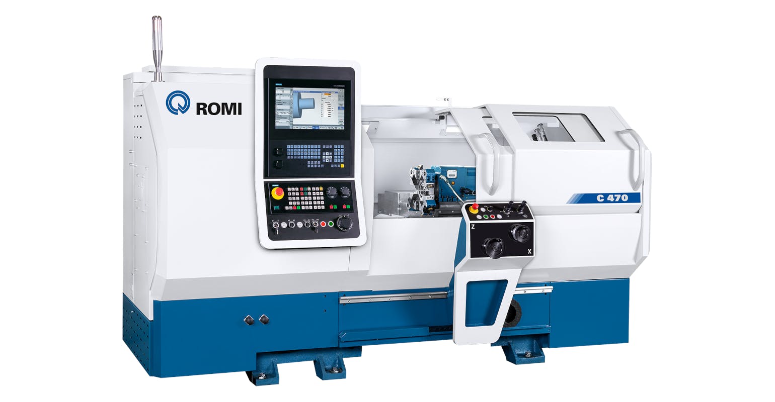

The New Generation C 470 is a teach lathe with an 18.5 in. (470 mm) swing over bed, a 4,000 rpm 12.5 hp main motor, and 39.37 in. (1,000 mm) between centers. It is equipped with the Romi Manual Machining Package (RMMP), which allows simple operations to be completed without any programming. It is as simple to use as a manual lathe but with a CNC lathe's added capability and productivity.
With the RMMP an operator can machine parts manually using the handwheels, or automatically using a joystick and start cycle. The operator also can fill in the fields on the CNC screen, indicating spindle speed, feeds, cutting depth, coordinates, and angles, and start the machining with the cycle start button.
All main components of Romi C Series lathes, including the robust monoblock bed, are designed and built in-house for complete control and assurance of manufacturing quality. The bed features a robust structure supported by cast-iron columns and is internally ribbed to absorb vibrations during machining, ensuring unparalleled precision and stability in every operation. Flat and prismatic guides are hardened and ground to ensure high wear resistance and are self-adjusting to provide permanent contact of the cross slide over the bed. These features result in high rigidity, stability, and precision in machining operations at full power.
It is powered by a Siemens Sinumerik 828D CNC drive, a high-performance control package with a 15-in., color LCD touchscreen and provides conversational programming, operation, and machining simulation resources.
