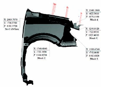

Measurements taken in the pilot studies averaged 59 min from site setup to final results. Typical accuracies were ±0.00079 in. on objects approximately 10-ft long.
GM uses FotoG close-range photogrammetry software to make 3D measurements of autobody components.
