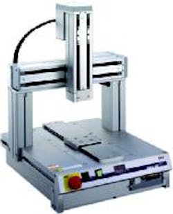

IAI America, Inc.'s (www.intelligentactuator.com) TT Table Top Robot line is available in gate or cantilever types, 200 mm by 200 mm (7.87 in. by 7.87 in.) or 400 mm by 400 mm (15.75 in. by 15.75 in.) X-axis/Y-axis operating ranges, and 2- and 3-axes models. All models have extruded aluminum bases, high accuracy ball screws and servo control motors. Positioning repeatability is +/- 0.02 mm, an X-SEL controller is built in and the unit can be used with a teaching pendant, PC software or other tools.
The gate type's Y-axis is fixed to withstand unbalanced loads while the cantilever type provides a wide, open work surface.
The 3-axis version comes standard with a Z-axis brake to prevent the slider from falling when the power is off.
The robot is configured to support DeviceNet, CC-Link, ProfiBus and Ethernet for the transmission and acquisition of position changes, production results and other data.
Application examples include coating, soldering, driving screws and circuit board inspection.
