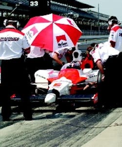

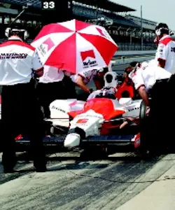

A driver stops for service in practice. Team members immediately place a cover over the car's front wings — to maintain secrecy at Indy.

In pit stops, mechanics visually check every car for fatigued or failing parts and adjust the chassis setup.
