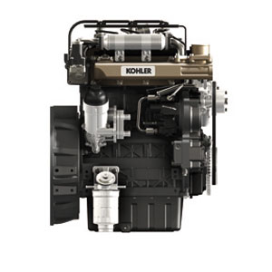

The 1.9-liter KDI1903TCR (above) has 42 kW or 56 hp of power at 2,600 rpm and 225 Nm or 166 ft./lbs. of torque at 1,500 rpm. Kohler’s 2.5-liter KDI2504TCR (below) has a power density of 55 kW or 74.3 hp at 2,600 rpm and 300 Nm or 221.3 ft./lbs. of torque at 1,500 rpm.
