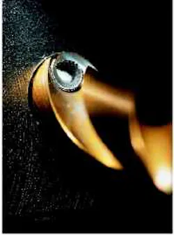

The flute profile is critical for optimal chip formation and evacuation.
