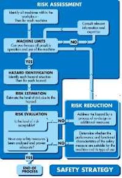

Assessing the degree of risk associated with a machine is a necessary first step in eliminating hazards or providing appropriate safeguards.
Typical Risk Assessment/Risk Reduction process.
Machine safeguards are designed to protect a company's most valuable asset — its employees. Using the right safeguard to reduce the risk associated with a machine hazard not only reduces both the direct and indirect costs of an accident, but also provides an opportunity to save bottom-line operating costs.
Choosing the best machine safeguard requires performing a Risk Assess-ment/Risk Reduction analysis. This helps a company determine the total cost associated with an accident and the financial and operational benefits resulting from the use of various machine safeguards. Such an analysis focuses a shop's attention on solving each machine-hazard problem.

Assessing risk
The process of developing a safety device to reduce or eliminate a hazard involves analyzing each element of machine operation. Hazards are a safety concern in areas where operators, maintenance personnel, or others must stand or pass by a machine. A machine may have one or more hazard points or areas of hazard. These include pinch points, web or roll nips, punches, shears, hot surfaces, blades, flammable vapors, and protrusions. Each hazard should be reviewed based on the function of the personnel approaching or using the machine at each location.
Generally, a risk hazard analysis starts with a list that matches each hazard to the task performed at a location. It is possible to have multiple hazards for each task and location, so a risk assessment for each hazard/location pair must be performed.
The first step in a risk analysis is to assign a risk value to each paired hazard/location as a function of three considerations: severity of a potential injury, frequency of exposure, and the probability of an accident. Each consideration is then categorized according to severity of a resulting injury, frequency of exposure, and probability of occurrence. A numerical value is then assigned to each of these categories. The following example describes the risk-analysis process.
