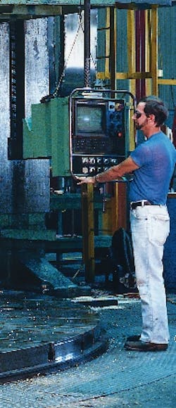

It's a Mesta vertical boring machine remanufactured by Dorries of Germany, and Voith uses it to rebuild hydraulic turbines for the hydroelectric industry. The company restores these turbines to like-new condition and increases their power output to generate more kilowatt hours.
According to manufacturing manager Steven Schmidt, the now CNC machine plays a critical role in the manufacturing of turbine components. Voith machinists re-bore the headcovers and bottom rings so that wicket gates and bearings on a vertical shaft accurately line up. These components vary in size depending on the unit. Smaller turbine components weigh 2,000 or 3,000 lb, while the ones run on the big Dorries can weigh more than 300 ton, measure 10-ft tall with 36-ft diameters.
The machine is built to handle the big stuff, having a 38-ft, 219-ton table that rotates at a top speed of 12 rpm. Two rams, one of which has a live spindle, feed out 10 ft, and the machine's adjustable columns provide up to 19 ft under the tool.

Three vertical boring machines were made by Mesta Machine Tool Corp. in 1940 to machine large gears for 16-in. gun turrets on battleships. Voith purchased one of the machines from the Navy in the late 1970s. Originally, the machine was a 40-ft vertical boring machine with no live spindle or table indexing capabilities. It had a hydrodynamic bearing and turned at a maximum 4 rpm. But, getting it up to even 2 rpm was difficult with a 100-ton load, says Dave Bahn. These slow speeds limited operators to old-style tooling because the newer tooling requires higher speeds. But all this changed in 1987 when Voith entered a partnership with Dorries to re-manufacture the machine into a modern CNC vertical machining center. The project cost $4.6 million, only 40% of the cost of a new machine says Bahn, and took 26 months.
As a result of remanufacturing, the machine now sports live tooling and table indexing. Voith can not only turn, face, and bore large diameters by rotating the table but also index it to drill, bore, tap, and mill with the live spindle. Jobs that were previously completed on up to four different machines can now be entirely machined on the Dorries in a single setup.
The new right-side live spindle has 50 kW of power and turns at 600 rpm. This spindle eliminates additional operations in the assembly department. The live spindle machines mating parts separately, but they are so accurate that they can be assembled in the field. Previously, parts were line bored together or handfitted to make sure they matched up. The live spindle boring operation runs much faster than line boring and eliminates the need for two to four-man crews working weeks to preassemble mating parts.
For the machine's table, Dorries replaced the original spur drive gear with a helical gear that has a pitch diameter of 32 ft. The table now turns up to 12 rpm, and an added clamp ring provides a braking surface for indexing. This involves a series of calipers that are off when turning, on with low hydraulic pressure when milling or indexing, and completely on for holding table position.
Because the machine's rail does not raise and lower, Dorries cast new adjustable columns. For more or less clearance, workers remove the rail and upper column sections as a whole and either add or delete separate column sections for the desired under-tool clearance. The machine's foundation was modified to accommodate these adjusting columns.
Voith basically raised the foundation's elevation so the columns mount on the foundation and to the sides of the machine bed. The foundation extends down 15 ft and rests on bedrock that's another 10 ft deeper.
The bed's once hydrodynamic bearings are now hydrostatic with an oil distribution system, and its old center bushing has been replaced by an antifriction roller bearing. An added encoder monitors bed speed. Finally, a differential control on the hydrostatic bed cools machine oil to several degrees below ambient bed temperature. This same oil returns to the bed at the bed temperature, minimizing thermal distortion for improved accuracy.
